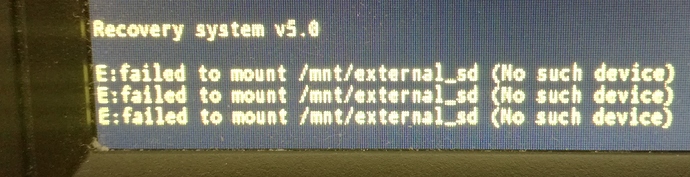

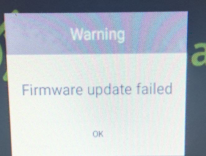

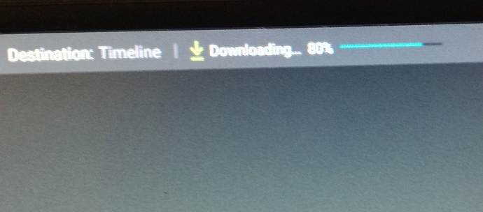

better and better … now nothing works !!!

hello, it was too beautiful!
So far everything was working, this morning again “” firware avalable “”
AND!!! the same problem as the first time, (see photos in the beginning) what to do !!!
