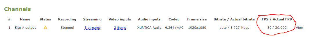

Another thing to check when this happens (if you’re able) is the Info page of the Admin interface. This page displays the target FPS vs the actual FPS. If the encoding dropped frames for whatever reason you should be able to see this on that page:
