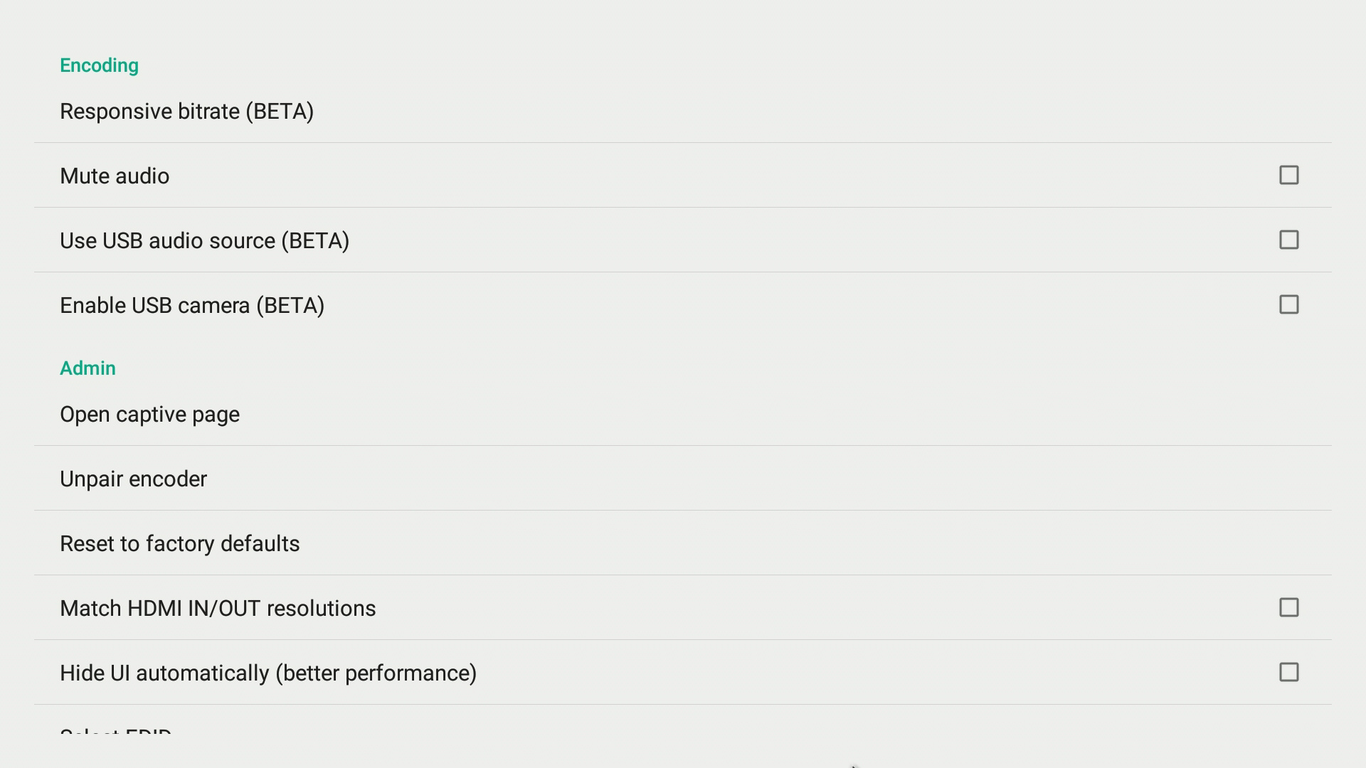

At the moment these are Switchboard options:

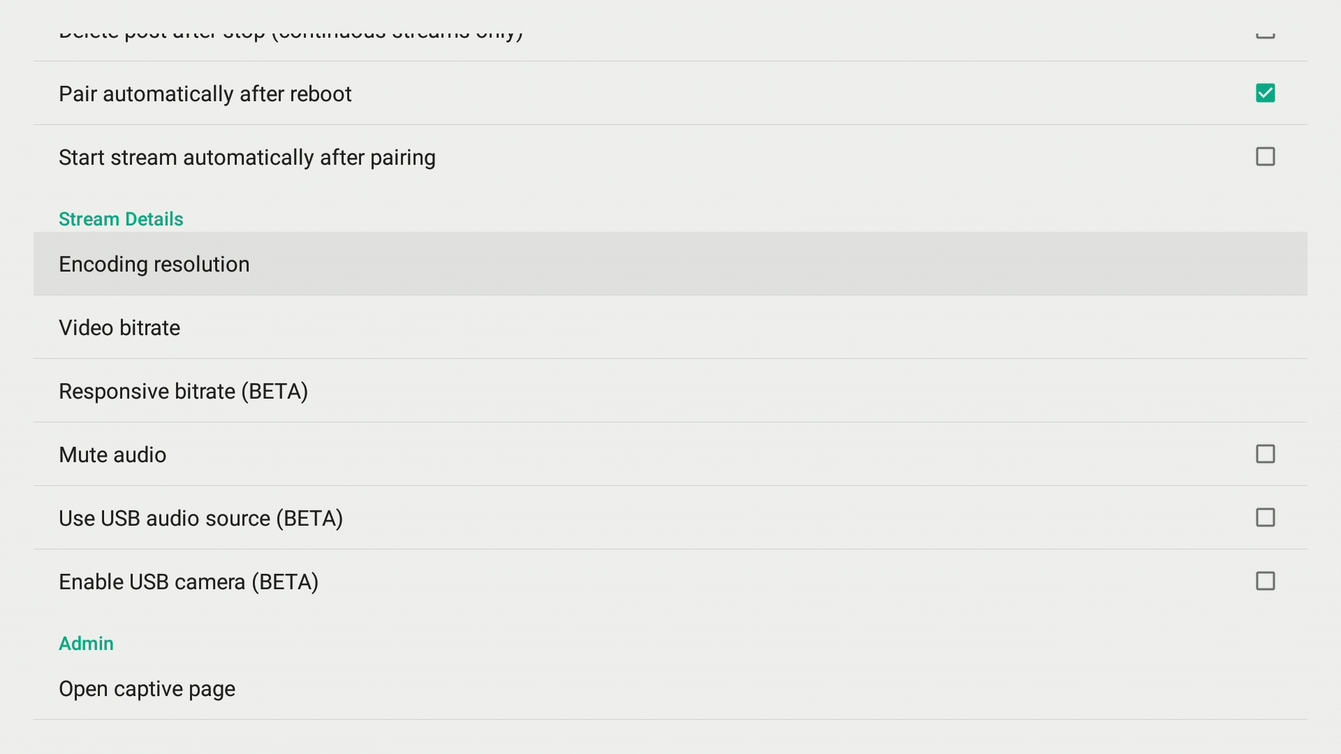

Youtube options:
