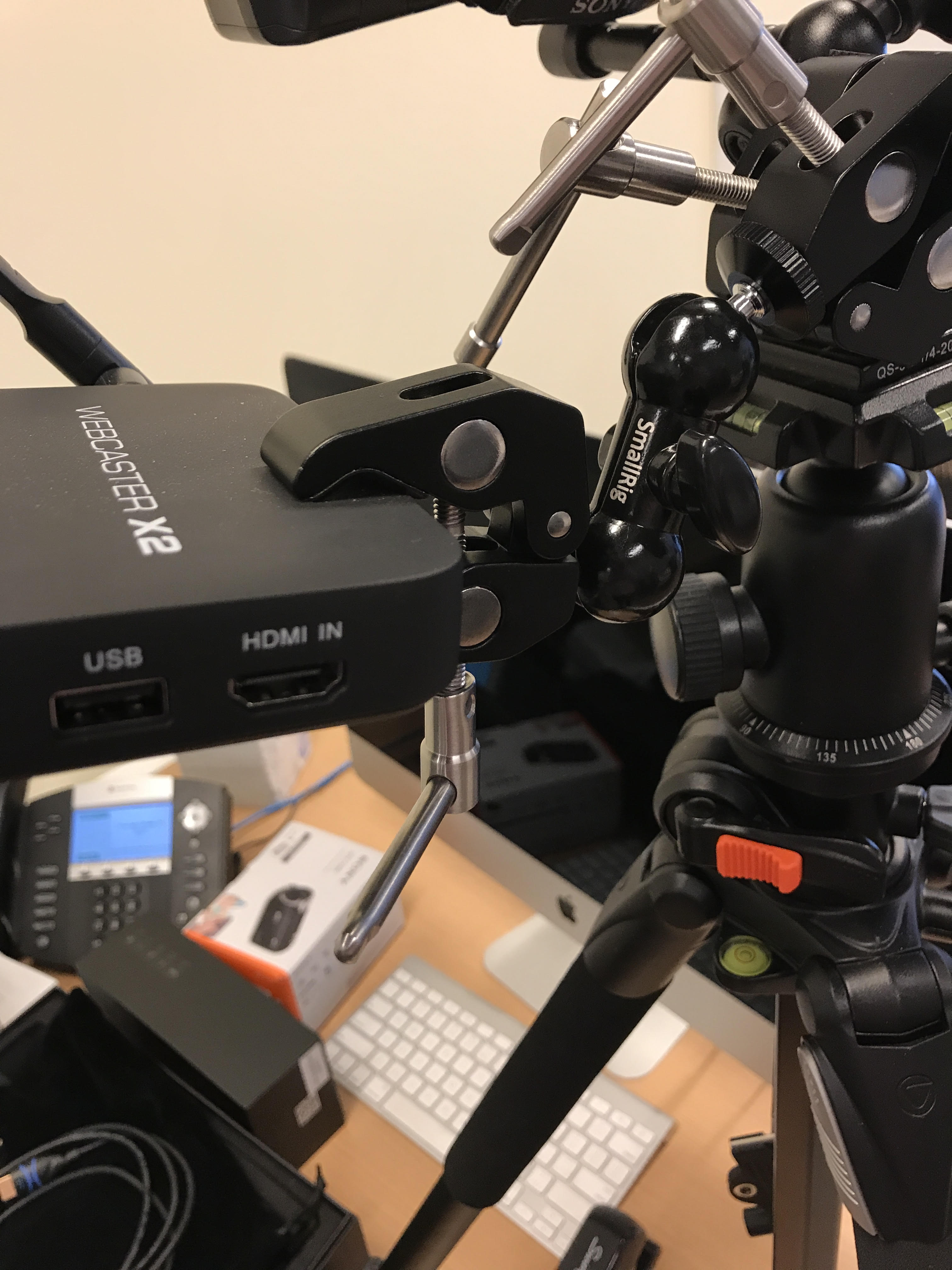

Uses a clamp to hold Webcaster X2:
Here is the clamp that is being used, lots of similar options available:

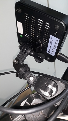

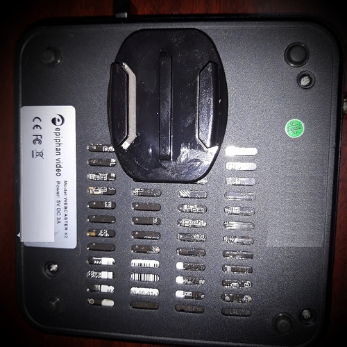

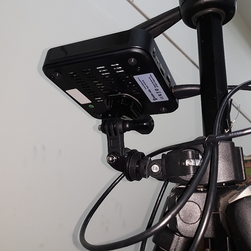

GOPRO MOUNTS with a Manfrotto Tripod. Really secure option, no problem with air circulation and you can still mount on top of the Webcaster X2 the HDMI audio inserter. Cheap option, specially if you buy “knock off” Gopro accesories. I recommend the GARMIN brand (Gopro like action camera) accesories. Very good quality materials (Got them on office depot with 60 percent off the regular price.
Couldn´t find it local so I ordered this part for the GoPro mount but it gets to high for top mount with the parts I have. If you mount it from the side or on the bottom everything gets in the way. Gonna look for another option. Will post then.

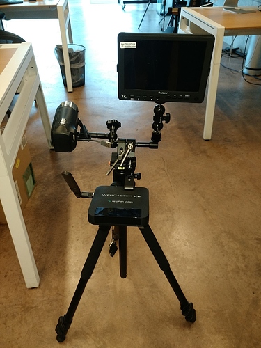

Nice setup @Arturo_Salcido!

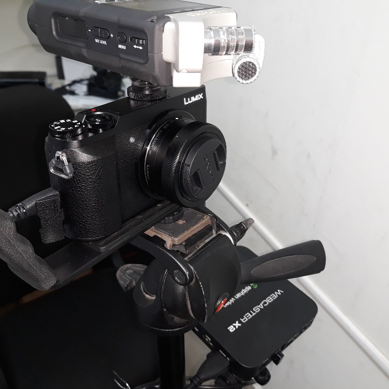

That the Panasonic Lumix GX80/85? It doesn’t have audio input, correct? Assuming you are using the H4N for audio with the Sabrent USB audio dongle to feed audio directly into Webcaster X2, yes?
Yep. Until you guys find something better thats my gear
