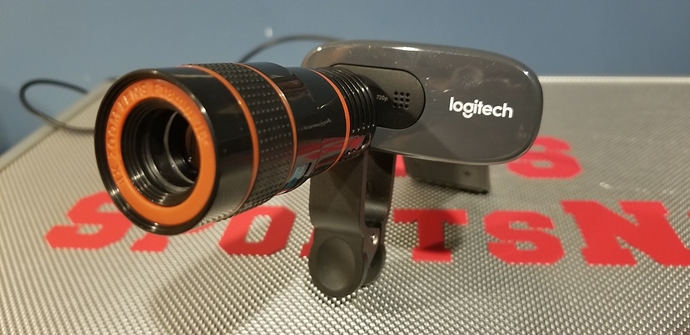

A cheap way to do this is with a clip-on telephoto lens made for cell phones. I clip a telephoto lens to my logitech c270 webcam. I tape the webcam to a small gorillapod, and tape the gorillapod to the wall. I use the smallest pip size, and put it in the upper right hand corner with a little transparency. Works fine for basketball in a small gym.

Any particular size that you use for the clip on telephoto lens?
From a distance of just over 40 feet I use an 8x clip-on telephoto lens, as shown in attached pic.
