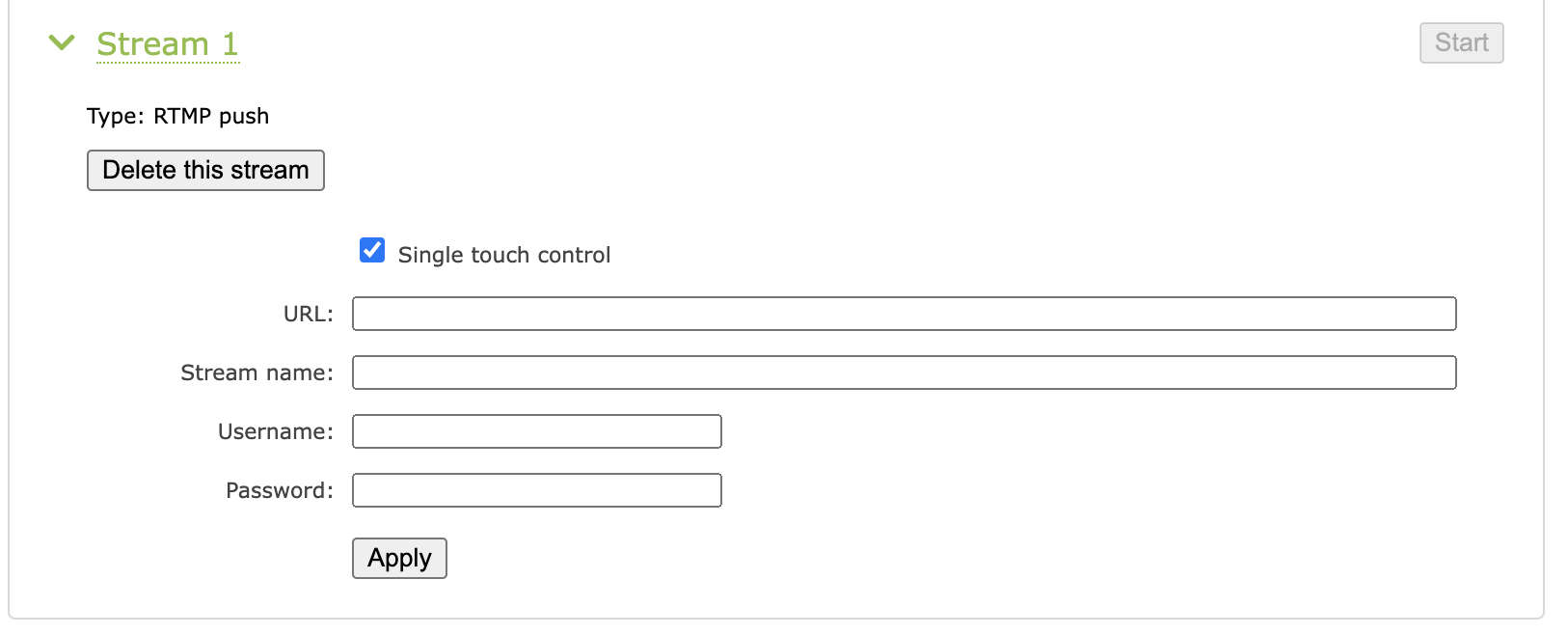

Hi I out chrome on incognito. I attached two screens, one with filled and other one blanked after I clicked Metadata and returned to Steaming page. Stream config remains, but it empty. I can ping and resolve names correctly i.e. network is ok.
Image removed due to privacy concerns
And this empty page after. I have pressed Apply, then Delete this stream goes get and comes back available.
Please try deleting that RTMP instance from the channel and creating a new one from scratch.
If the issue persists, please try from a different browser
I would also recommend performing a factory reset to ensure that there are no low-level UI bugs introduced from jumping 12 firmware versions, and manually reconfiguring the device
Hi Tried with two browser, safari and Chrome. same results. If I add Stream, config (URL and stream name9 and click apply, Start button is grey. If I click Stop All (there is no streaming air though) and stream settings are empty again. I didi factory reset once, maybe I have to do it again? It sounds bug in latest fw.
I noticed you also sent in a support ticket so I will continue correspondence there for troubleshooting. Based on your wording, please ensure that you attempted a factory reset by going to the very bottom of the maintenance page and clicking on the factory reset option. There is a configuration preset section which shows “factory default” which refers to the configuration, however this is not a reset
Hi, Yes I Did factory reset. For example IP changed and channels changed
After careful troubleshooting, we were able to determine that there was a remote-access security measure that was preventing the settings from being applied.
Logging in via Epiphan Cloud to configure resulted in expected behavior
