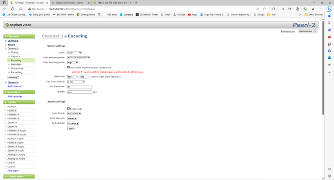

Do you only notice these issues when there are lots of folks on your network, or specific times during the day? Could you share a screenshot of your encoding settings for your channel?
Hi Ryan,
Thank you for your help. to answer your questions, we don’t generally have anyone online via our netwrok whilst streaming. As we generally stream on a Sunday morning service we have only tried a couple of times outside those hours but it still seems to be an issue. I’ve screenshot the settings as you asked ( I hope!).
Thank you again for your help
Hello!
hmmm could you try unchecking “use current signal resolution as frame size” and then choose a resolution? 1920x1080 is pretty standard these days. Press apply after choosing your resolution,
If you are switching between sources that are different resolutions, with this setting checked it would cause the encoding resolution of your channel to change. This might, depending on the CDN, cause some issues.
