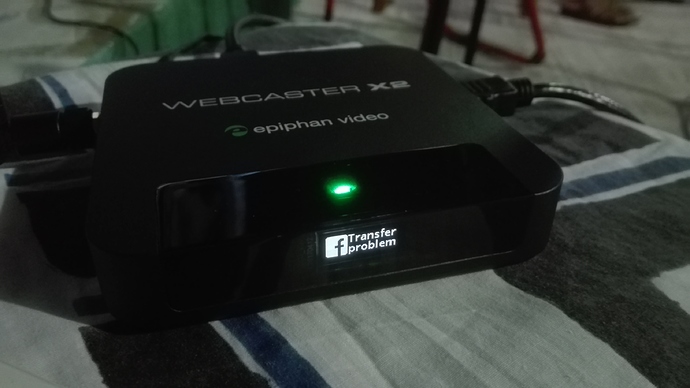

I think my network is secure (passe word to get in my wifi), morever i’ve alreay updated the firmware. Since my setuping the device, 2 weeks ago. For illustration of my issu, let me show u a picture on this error

Media Transfer Problem, as discussed further up in the thread, is typically a network issue. Either blocked traffic or low bandwidth.
Try reducing the bitrate to the lowest setting for a test stream and see if that help. Also run a speed test to see what upload speed you are getting. a good rule is bitrate x1.5-2 is the minimum speed required. eg. 2000kbps *2 = 4000kbps/4mbps min upload.
If you have a slow or inconsistent upload bandwidth it’s possible that your network may not support streaming at that current speed. Another thing you can try, if you are trying to stream using WIFI is to do a direct LAN connection for a more stable and reliable connection.

A media transfer problem would be the Webcaster X2 unable to push the encoded data to the destination server. This could be anything in between; network, firewall, or internet connection. For example it could be wifi reception, so try ethernet. It could be firewall, so test on a DMZ (demilitarized zone). Or it could be internet speeds, so try running a speedtest https://www.google.com/search?q=speedtest
