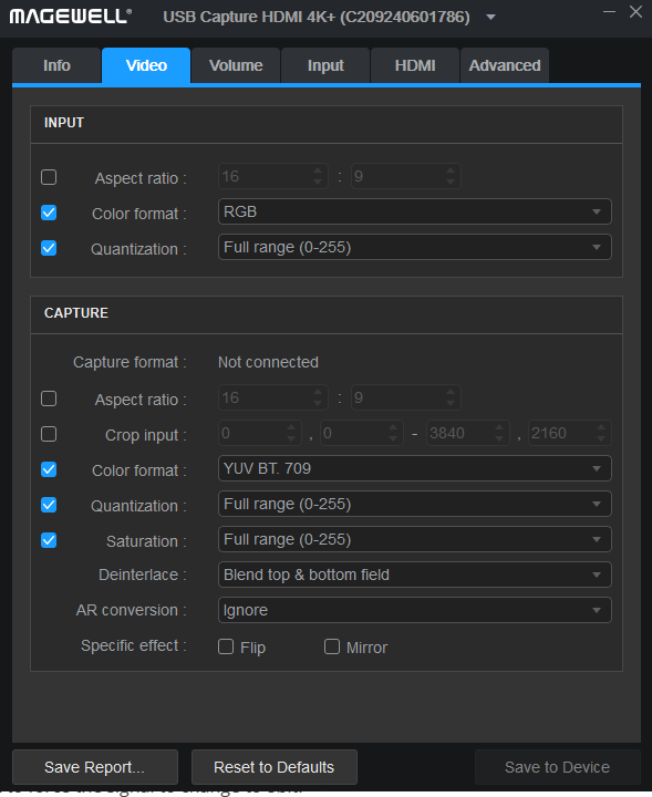

Hi Adam
I can set the settings as shown in the picture in MAGEWELL, but how do I set the video range in AV.IO 4K ? Please tell me how.
Thank you.
I’m afraid it’s not possible to modify this behavior using the AVio Configuration Tool as you can with the Magewell device and its configuration software. You would likely need to adjust this in the capture software. The AVio 4K will capture the signal as it receives it and then pass the signal to the software as requested, using one of the following color spaces: YUY2 (4:2:2), NV12, YV12, or I420 (4:2:0). You can also send an email to support@epiphan.com to open a ticket with us to continue troubleshooting.
