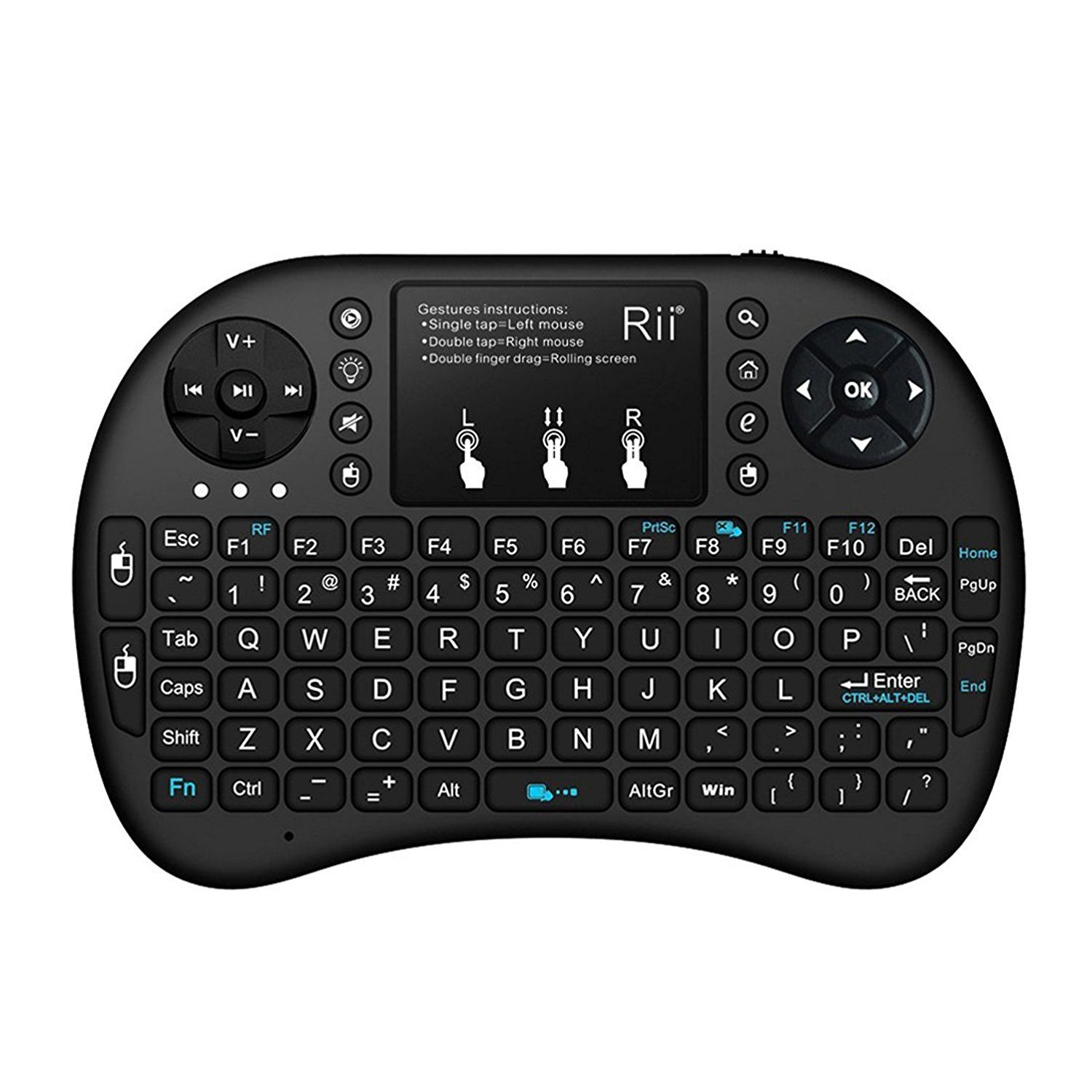

Also using a wireless keyboard here. I prefer the $20 Rii mini i8+, just make sure you get the version with the dongle and not the bluetooth version, works perfectly with Webcaster.
