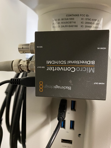

Here is the model I am trying to use.
Thank you for the help on this! Here is the model I am using.
Tim Frye
It looks like there should be some switches on the converter itself, and it’s possible the default might not accommodate stard SDI or 3g-SDI. Page 53 of the BM user manual provides the steps on how to set the switches correctly for SDI other than 6G or 12G
Hopefully changing the switches based on the SDI needs will converted to a recognized format standard!
